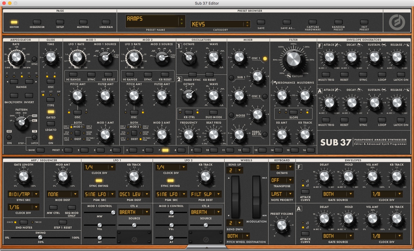

anomalous filter slope behaviour
setup as signature
attempted to setup attached as new init preset as follows
bank 10 preset 1 init preset
filter cutoff 2kHz resonance 50% slope 24 dB
mixer osc1 on rest off
oscillator 1 16’ wave saw
mod 2 rate 1 Hz source program
pitch amt 2 fiter amt 2
dest program mod2 amt-5
source sine dest slope
NO slope cycling
in editor moved slope to 6, 12, 18, 24
partial slope cycling 6-12, 12-18, 12-18-24
still seems slope cycling is strange after initial success las week
preset 9,7 still works
cleared all references - problem stopped
are preferences so sensitive?
if so what about a “clear preferences” button?
