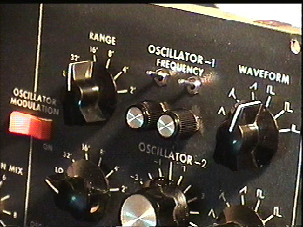

I finally did it. I added oscillator sync to my Mini.
Osc 1 as master, and either Osc 2 or Osc 3 as slaves.
Here’s what it looks like:
I didn’t have big enough shrink wrap for the doubled wires…
Here we see the two diodes. The resistors are inside the shrink wrap.
The two rather discrete toggles…
The other half of the connector, with its wires leading to the oscillators board…
Thanks to Kevin Lightner for providing the schematics for this mod, on his Synthfool site.

Thanks Kevin. I’m not sure I want to do that yet. It took me a while to bring myself to install this mod, as discretely as possible. Now, I’m not saying it’s not tempting… But I’ve got other synths that already have those capabilities for now.
With this, I just wanted to add the possibility of having two, or more, oscillators synced together, for when I want suboscillators style sounds, for example…
Thanks for the suggestion though. :smiley:

Actually it sounds just a tad weird. A little “dirty” (in a good way).
Here’s a short audio clip where at first there is only the master (osc 1) and one slave (osc 2) and at the end the second slave added (osc 3):
http://soundcloud.com/thealien666/minimoog-sync/s-ClGC3
EDIT: before someone asks me how did I manage to send the envelope to modulate the pitch of the slave in the first part, I didn’t. I couldn’t. I was moving the pitch knob of the slave by hand…
On a side note, except for the two toggle switches, shrink wrap, and tie-wraps, everything else, the wires, the diodes, the resistors, the connector are recycled parts. I believe in recycling, especially when it prevents me from having to buy new parts ! :smiley:
So I guess my Minimoog can now be classified as “environmentally friendly” too ! :laughing:
