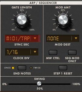

You mean in the editor page…under the arpeggio section.
And then put these parameters in the sync src…course this casket has in anyway no function on the moment.
Regards Luloop
Hmm, I can see the logic for having Phase Reset over on the Setup page – it’s a global parameter. Everything in the ARP and Sequencer sections is stored with the preset, no globals allowed. I agree that it is hidden. Just butting in; never mind!
hey Lu,
no, I meant the setup page.
On the panel, the arp section is on left, on the editor page the the arp/seq page (bottom) is left, but on the setup page the seq options are in the middle.
