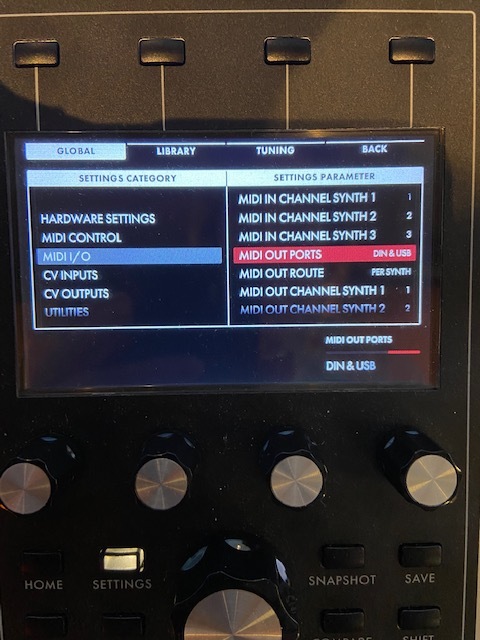

Here I can show you, the the MIDI Monitor displayes that the moog send out the same data on all the 3 different midi channels imoultiously without activating the keyboard contols ‘on’.
This is even without preloading any DAW only the midi monitor is on.
Any explenations?

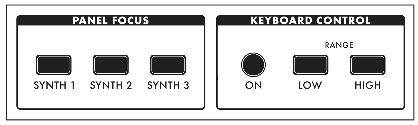

just to make sure we are talking about the same thing…
turn off keyboard control for all synths, to verify that your ONE doesn’t send any MIDI notes.
PANEL FOCUS > SYNTH 1
KEYBOARD CONTROL > ON to OFF
PANEL FOCUS > SYNTH 2
PANEL FOCUS > SYNTH 3
now, turn on keyboard control for only one synth.
KEYBOARD CONTROL > ON to ON

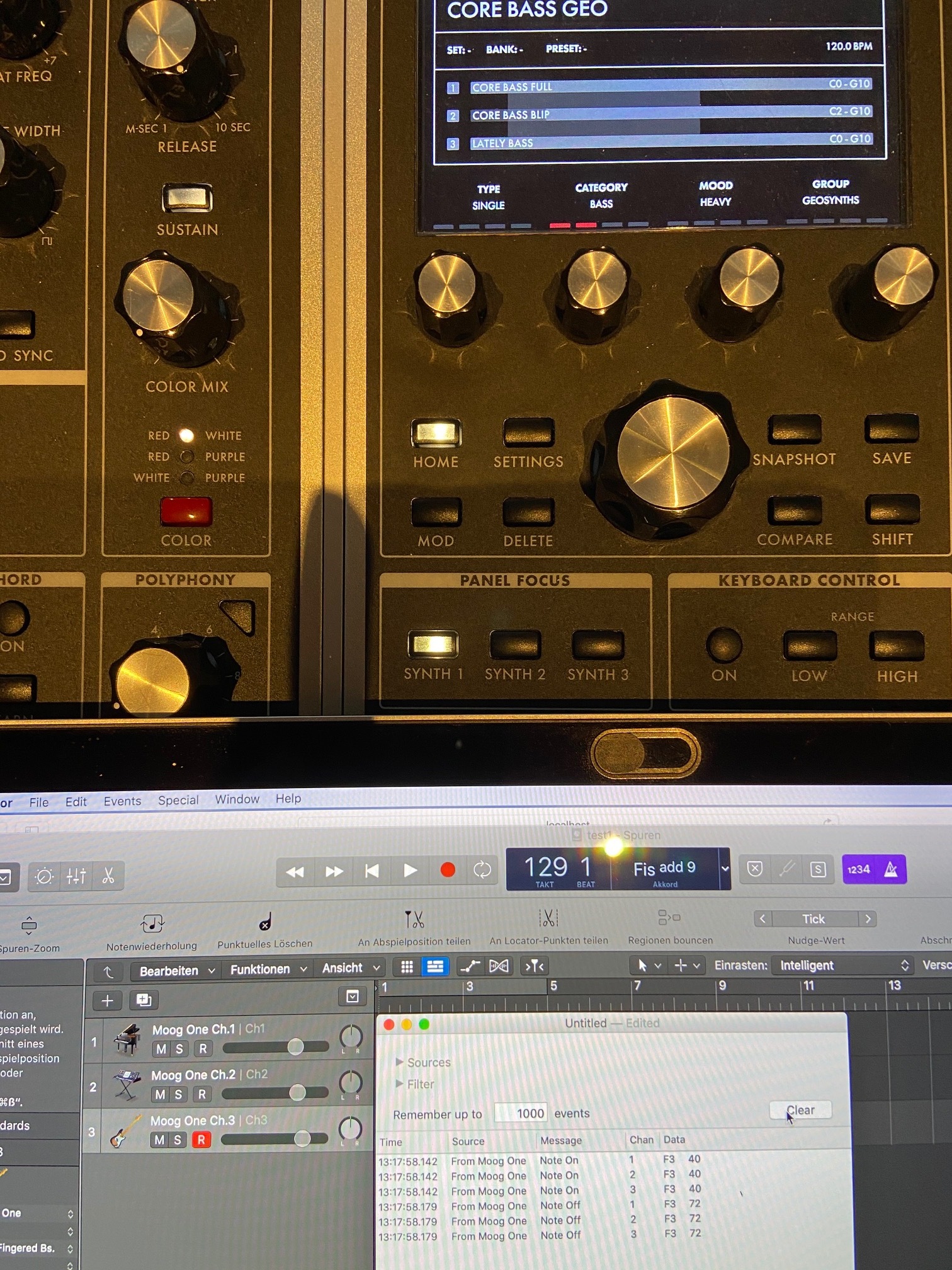

I installed Logic 10.5 on my MBP to show that this obviously not a singular matter of Ableton Live.
As you can see on the Panel Focus all Synths are turned OFF.
Whether a midi channel in Logic is aktive ore not (you see it in the two attachements), if I hit a key the are midi Note on and Note off messages seen in the MidiMonitor Window on the Logic surface.
And as you can see in the 3rd Attachement the Midi i/o settings are perfect.
Any idea why the Moog obviously behave like that?

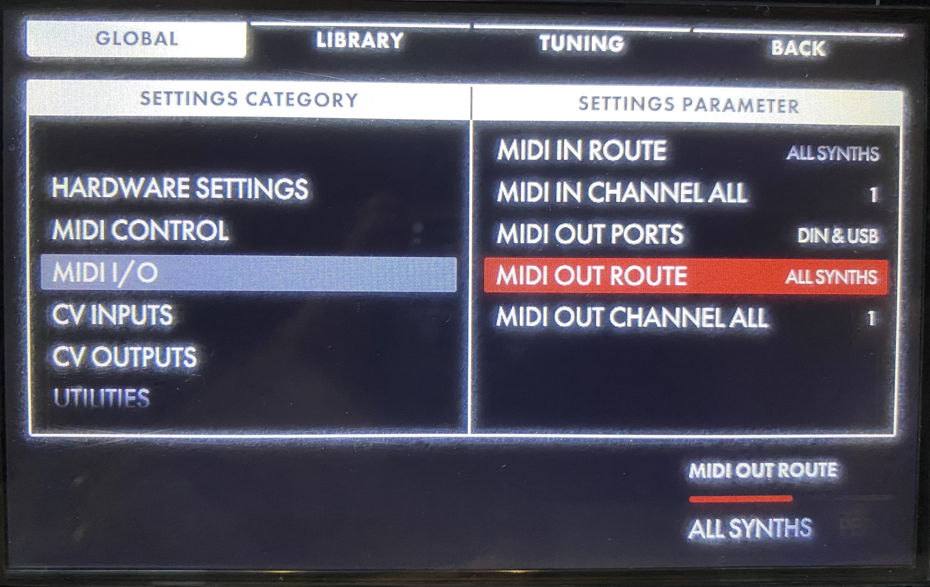

Change to the following in the Settings.
MIDI I/O > MIDI OUT ROUTE > ALL SYNTHS
this should solve your problem.
You will still be able to trigger individual synths through their respective MIDI channels.
Sorry I have to disappoint you, the settings you suggested send midi only on channel 1, never the less which synth I have turned on.
For me was important to find a setup which definitly sends only midi on which that was predefined.
I think moog suggests it when using Midi rout in/out Per synth for different channels. Thats what it seems to mean.
BUT: It doesn’t work that way.
As you can see in the pics above (the white displayed window in the Logic part - it’s the midi monitor window), when using this configuration the moog sends - even if any synth is turned “on” in the keybord control part- midi Note on/off messeges out on all the predifined channels.
