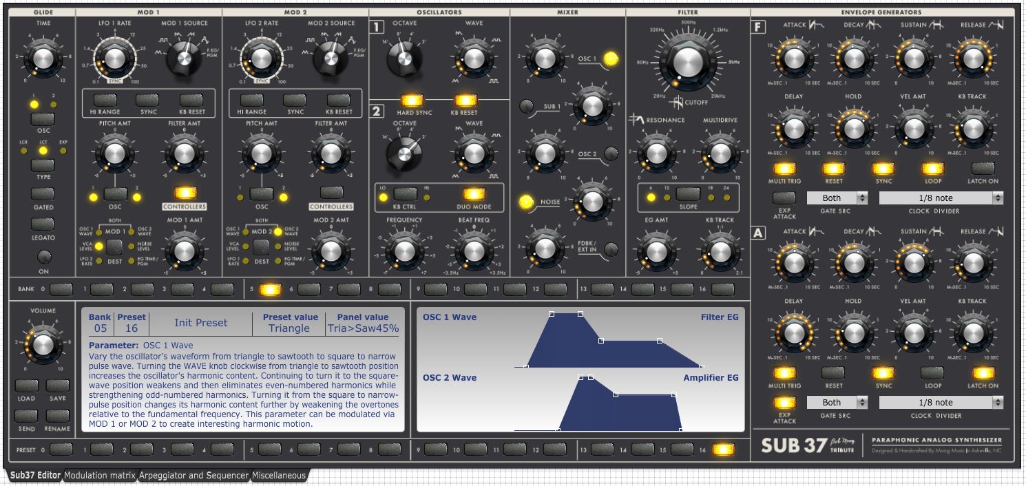

Hi Amos,
I'm the happy owner of a Sub37 which is a fantastic synth.
However, since the beginning I have been lacking the visibility on the actual parameters values (buttons do not have a motor to be positioned at preset value when loading a new preset :D ).
Explanations from the manual are also very important and every word is key so I also wanted to see this when tweaking...
I decided thus to build an editor that would allow me visualizing that.
I found Ctrlr and I'm busy to build a panel for it.
I can already achieve nice things as:
- panel layout with look and feel as the real synth
- DAHDSR enveloppe graph display
- selection of Filter or Amplifier EG graph display
- direct access buttons for EG parameters using the Shift button on the synth
- name and actual value of parameter is displayed in the “screen”
- explanation of the parameter from the manual is also displayed
- leds acting according to button's selection
- series of radio buttons for the bank selection
- series of radio buttons for the preset selection
- load and save .syx file buttons (no code yet)

I'll keep this image updated according to progress
