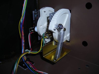

Turned out it was a dry joint on the 12v pin at the bender connection !

Hey Tony -- I found your post about the Rogue pitch issue - not sure if you're still connected to the forum, but am asking & reviving if you, or anyone can help... I recently had the same problem on my Rogue - any sustained note raises in pitch... and keeps going(!) wondering if you, or any others could clarify your fix?
"...Turned out it was a dry joint on the 12v pin at the bender connection !..."
I'm guessing the 'bender connection' is at the pitch wheel, correct? I've not opened synth yet - just wanted to clarify what I'd be looking for (wire color?) to re-solder the connection....
Thanks for any help in adv.
Cheers J.
